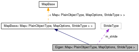

Inheritance diagram for Eigen::Map< PlainObjectType, MapOptions, StrideType >:
Collaboration diagram for Eigen::Map< PlainObjectType, MapOptions, StrideType >:
