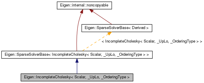

Definition at line 51 of file IncompleteCholesky.h.
typedef SparseSolverBase<IncompleteCholesky<Scalar,_UpLo,_OrderingType> > Eigen::IncompleteCholesky< Scalar, _UpLo, _OrderingType >::Base [protected] |
Definition at line 54 of file IncompleteCholesky.h.
