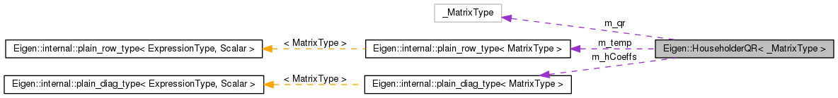

Static Protected Member Functions | |
| static void | check_template_parameters () |
Protected Attributes | |
| MatrixType | m_qr |
| HCoeffsType | m_hCoeffs |
| RowVectorType | m_temp |
| bool | m_isInitialized |
